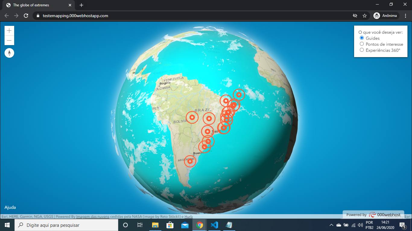

Hello guys, I'm using this tutorial as a base: https://www.esri.com/arcgis-blog/products/js-api-arcgis/3d-gis/interactive-3d-globe/ my doubt is how to add a grouping of the added points. I already tried to use the clustering system that is in the documentation and it was not effective for me
This is the markers code:
 const extremesLayer = new GeoJSONLayer({
 url: "extreme-points.geojson",
 elevationInfo: {
 mode: "absolute-height",
 offset: offset
 copyright: "Powered By <a href=\"https://visibleearth.nasa.gov/view.php?id=57747\" target=\"_blank\">Imagem das nuvens</a> cedidas pela NASA (image by Reto Stöckli) e <a href=\"https://hurb.com\" target=\"_blank\">Hurb</a>",
 renderer: {
 type: "simple",
 symbol: {
 type: "point-3d",
 symbolLayers: [{
 type: "icon",
 resource: { primitive: "circle" },
 material: { color: [0, 0, 0, 0] },
 outline: { color: [245, 99, 66, 1], size: 4 },
 type: "icon",
 outline: { color: [245, 99, 66, 1], size: 2 },
how to add a cluster? help me pls Sorry for bad English

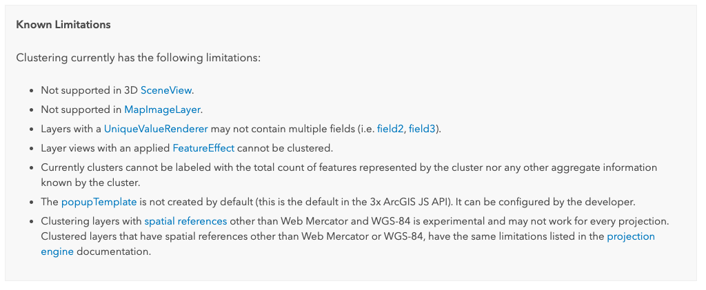

Noah-Sager
Current known limitation for clustering:

Hy @Noah-Sager,
Is the limitation permanent or is it under development ?
Thanks,
Flavie
Noah-Sager
Hey @FlavieMoraux. Unfortunately, it's still a known limitation at this time, and I can't speak to what the future holds. If you want to submit an Idea, that might help as well.
