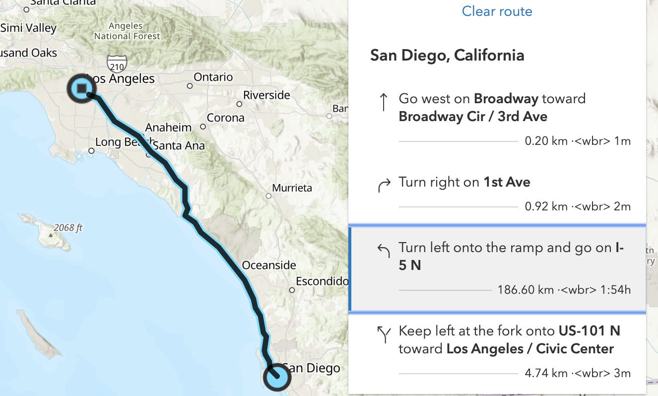

Hello,
I just upgraded an application to latest JS API 4.14 and noticed a small bug with the directions widget: <wbr> html markup is visible between the distance and the time. It is easily reproducible using the following sample:
Directions widget | ArcGIS API for JavaScript 4.14
On a side note, I find it a bit confusing that minutes' abreviation is "m" rather than "min".
Thanks !

Hi Nicolas, thanks for reporting this. We are aware of the <wb> issue, and are currently investigating. That is also good feedback about the m/min confusion, I will pass that along.

Quick follow-up, we've fixed the <wb> issue, which will be available on js-next soon (and for the next release of the API).
feedback-js-api-next/CHANGELOG.md at master · Esri/feedback-js-api-next · GitHub

Thanks ! Indeed, it is solved in 4.15.
Too bad minutes' abreviation is still "m" rather than "min".
Minute - Wikipedia : "The SI symbol for minute or minutes is min (without a dot)"
