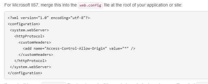

Enable-cors.org states that for CORS on IIS7 you need to “Merge this into the web.config file at the root of your application or site” and gives you a bit of XML to insert.
I wasn’t quite sure where I would add it and, using trial and error, several IIS service restarts later, I seemed to have some successes: several times I was able to load a layer which it previously had refused to load. Then, other times, in other applications it would suddenly refuse to load them ( the error message had changed now and was saying something along the lines of “Access-Control-Allow-Credentials request not permitted when the rule is "Access-Control-Allow-Origin" value="*" or so.
Hm, yes, that’s the rule in the XML from enable-cors that I’ve added to the Web.config at the root of my IIS site. So why is it not working in this case?
Turns out that, apparently, while the above rule (XML) from enable-cors.org opens up the web server to allow all sorts of Cross-Origin-Requests being made, current browsers consider that to be too insecure to accept and refuse to load some secured layers (which are kind of requested using credentials, I believe). So we’ll need to be more specific and set up rules on the Web Server which allow making requests from a variety of sources that are getting mashed up in our application.
