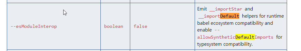

Typescript compiler options are explained here. For -- esModuleInterOp
So the defaults is
false.
In my tsconfig this was true. So I changed it to false and tried with both
"target" : "es5", and then
"target" : "es6"
Both result in: Uncaught TypeError: Map_1.default is not a constructor
Next, I compared --esModuleInterop: false using either "es5" or "es6". Here, I get no errors but my code is ignored as before.
Finally, I came across this thread saying there are no default exports included for arcgis-js-api typings.
