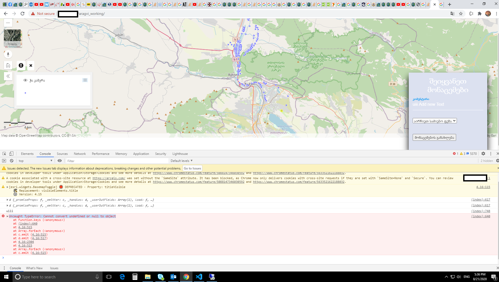

Vakhtang_Zubiashvili
Hi Robert,
I tried different ways and now i can get my layer, but still some problem. When i click ones it returns layer, but in my form it does not appear and when i click second time it appears in form, but when i change text it returns error :
 ---- Uncaught TypeError: Cannot convert undefined or null to object
Here is a screen shot and code (Code is a standard Applyedits, just to show you where featutreLayer goes) for review:
