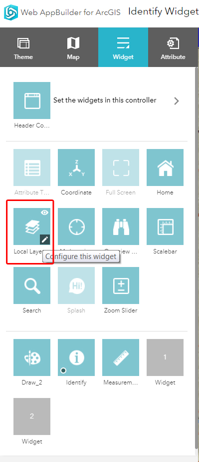

Jason,
   Nope that looks right. So when you create a new app you should have it appear like this:
