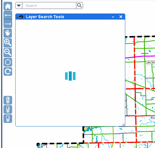

How do I remove the "Blue colored" loading bar image?
Very Annoying when you already have a gray loading bar.
This appeared in WAB 2.11
bars
RobertScheitlin__GISP
MVP Emeritus
Then this is what you are looking for:
.jimu-loading-indicator {
  display: none !important;
MVP Emeritus
Rich,
  I believe this is what you are looking for.
.jimu-loading-shelter {
Add this css rule to your themes common.css
RichBell
Thanks
The "css" change did remove the bars as the main map page is loading (Fixed)
but it still loads for individual widgets. Can this be removed?
MVP Emeritus
RichBell
Nice!
