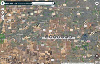

 Adjust the position values here, and the launchpad bar will move. Here's mine, with the values set a bit ridiculously at "height": 300, "right": 200.

jCarlson, you are right and I was wrong by thinking it's not in the main config, but, I don't want to move it higher... I want to move it more to the rightside (currently it's centered), and I want to make it wider so that I will be able to see more wdgets concurrently.
