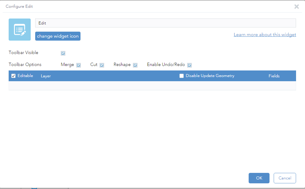

Hi,
1. i am trying to draw polygons and edit the existing polygons and need to save updated details into the database. But, i am not able to add service layer in the default edit widget of web app builder.
2.when am trying to configure the default edit widget,i have enabled the editable beside to the layer but  the list of the editable polygons is not visible as below.
Thanks in Advance
RobertScheitlin__GISP
MVP Emeritus
d ibrahim,
  The widget looks in the maps layers and attempts to find any editable layer. For a layer to be editable it has to have a FeatureServer url, this is different from the standard MapServer url. Do you have layer that have been published with the Feature Access option checked when published by ArcGIS Manager?
Naveen_KumarKairamkonda
Hi Robert Scheitlin,
Thanks for your quick response.
I have a Feature server URL. It have been published with feature access option. below URL is the feature server layer
https://svarcuat01.mwc.melbournewater.com.au:6443/arcgis/rest/services/DSS/EditableFeatureService/Ma...
Where i need to insert this URL in WAB ?
Thanks in advance.
MVP Emeritus
D Ibrahim,
This url needs to be added to the Web Map that you use in your wab app.
