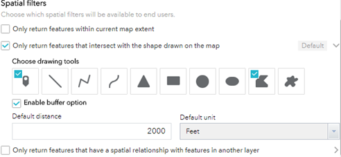

I am using the query widget in Web Appbuilder and have setup several query criteria. I also use the spatial filter "Only return features that intersect with the shape drawn on the map" in the widget, and set up as shown below.  The problem I am having is the query will only execute if I use spatial filter.  I need this to be an optionally used filter.  When I set this widget up initially, the spatial filter use was optional.  But some months ago the query wouldn't execute unless I used the spatial filter, which meant selecting a point on the map or drawing a polygon.
Is there a setting I am missing that will let this function optionally?  Any insight into this issue is much appreciated.

Todd,
You need to change the default setting right side of screen shot in query widget setting.
