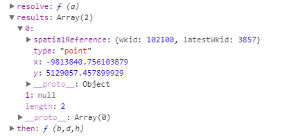

I compared the deferred object in my example and the JSFiddle example too. I don't see any differences except that the example contains a valid array in the results attribute (see below).

Here's how the example's deferred result looks:
Here's mine!
