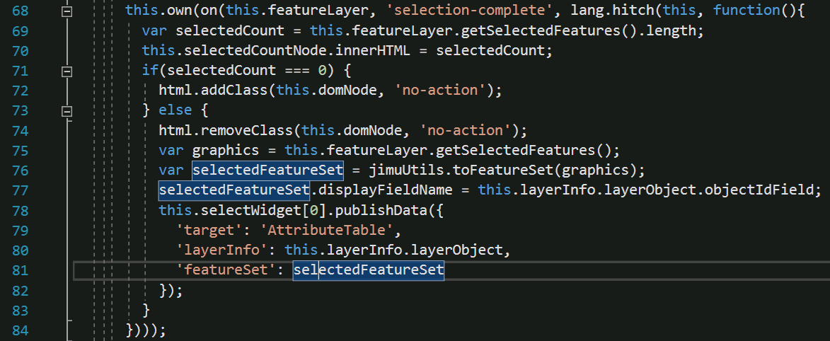

RogerF
Robert,
I made following changes in SelectableLayerItem.js of Select Widget and it seems to be working so far. Please let me know if there is a better way of doing it
Thank you,
RobertScheitlin__GISP
MVP Emeritus
That look good to me.
