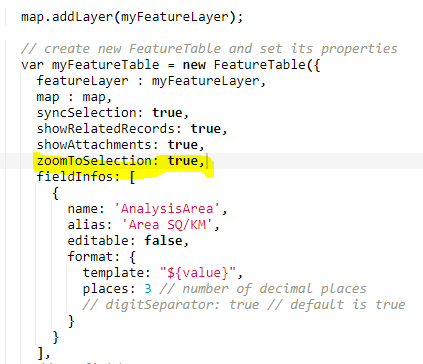

Hi Guzaloi,
You can try the FeatureTable, it has an property 'zoomToSelection', which will zoom to selected records.
ArcGIS API for JavaScript Sandbox
