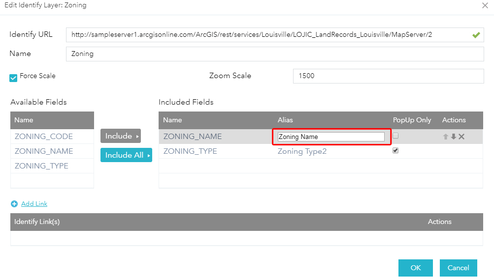

Hi Robert
Thank you for this Identify widget. I downloaded the latest version 2.12. The unzipped files show 2/8/2019 timestamp. It works great.
However, there is no place to customize useralias,(See attached screen).
I worked around it by manually add my aliases in this file:
\WebApbuilder2.12\server\apps\13\configs\Identify\config__6.json:
...{ "name": "General Plan", "url": "http://www.carsonproperty.info/arcgis/rest/services/basemap/MapServer", "id": 27, "zoomscale": "", "forcescale": false, "fields": { "all": false, "field": [ { "name": "GP", "useralias": "General Plan", "alias": "GP" } ] }, "links": {} },
This is a minor thing. Just want to ask and see if I got the wrong version. I searched old posts and saw it mentioned here too. https://community.esri.com/docs/DOC-1731-enhanced-search-widget-version-211-020819?commentID=50280#c...
Thank you again Robert. Appreciate!

Bing,
   That issue was fixed back in version 2.5.0.1. You can change the field alias by double clicking on the alias cell in the fields table and once you save the change the userAlias will be added to the config.json file.

BingJing
I just tried the "Double Click" and it is working. Thank you again Robert...
