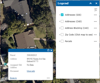

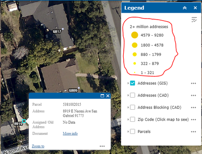

Hi Robert:
This code is great and it did work although did not work whenever I expanded a layer to see the icon symbology and left it expanded prior to zooming in or zooming out. Can this be easily rectified? See photos below. One photo shows the icon symbology of an expanded layer that is no longer visible in the map. The other photo shows no icon symbology and no layer name for the same layer that is no longer visible in the map if the icon symbology was not expanded prior to zooming in or zooming out.

I tried adding the text "html.addClass(contentDomNode, 'not-in-scale'); " and "html.removeClass(contentDomNode, 'not-in-scale'); " to the widget.js as seen below although it did not work.
{                html.addClass(layerTitleDivIdDomNode, 'not-in-scale');     html.addClass(contentDomNode, 'not-in-scale');
I also tried adding .jimu-widget-layerList .not-in-scale .esriLegendLayer {display: none;} to the css and that also did not work.  I was not sure how to change the LayerListView.js or if it was needed at all.
by Anonymous User
Not applicable
It looks like this same type of logic needs to be applied to the layercontentnodeid
