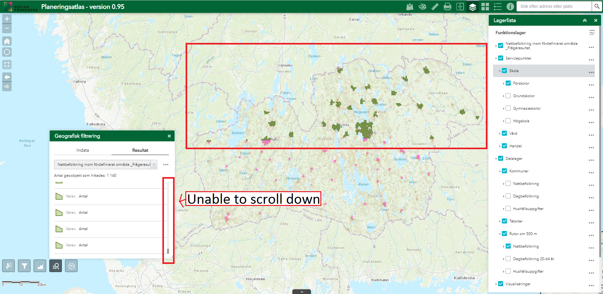

Hello,
we are experiencing a problem with the geographic filter availible in the query widget. We use the widget in order to select features from a grid with population data (the grid contains approximatley 5 000 polygons). In the query widget, when a large number of polygons are selected by one or a few selectors, it is necessary to scroll down in the results if the tool is to select all the squares. However, when the number of selectors increase the widget is unable to select the features that it should. See attached images.
If anyone has a solution to this problem we would be very grateful!

Possibly because your maximum number of records returned by the server is set to low.
Be advised the higher you set it the maximum number of records the longer your response time will be.  Especially with a polygon layer
