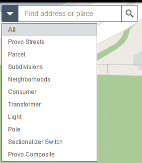

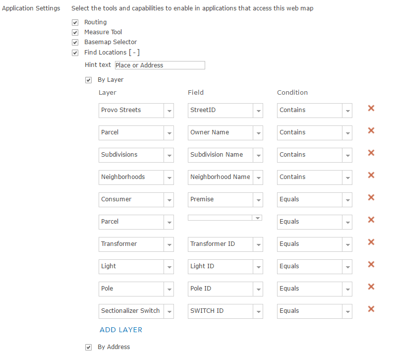

In your web map on AGOL you can set up default searches for your web map for features in your map.
The different searches can be seen when you click on the drop down arrow on the left of the search bar.

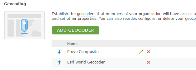

Also you could create your own custom locator that can search (geocode) by features. Then add that locator to your organizations list of locators and it will show up in the drop down list by the search bar too.
