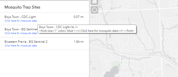

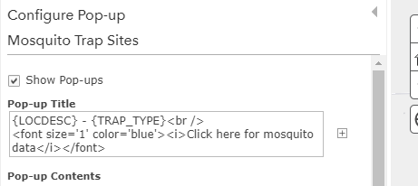

I am using near me widget in WAB. To achieve a desired formatting of the text in Result List I added a basic html formatting to the pop-up tile of the searchable layer in my web map. It worked just the way I wanted to display results, but the tool tip shows raw html text. I would like to change a text of the tool tip, or remove the tool tip all together. I looked thought the code, but I just cannot figure out how to do it. Any help would be greatly appreciated. Thank you.

   If you are using the developer version then you can comment out the code that set the tooltip.
In the widgets item-list.js file @line 644 comment out:
domAttr.set(divItemName, "title", value);

NataliyaLys
Robert,
That's exactly what I needed. Thank you.
