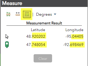

AndrewHayden1
I included a screen shot above.  It worked for the hover (the first line), but not the click (the second).

RobertScheitlin__GISP
MVP Emeritus
Andrew,
   OK, I see the issue now. The _updateClickLocation function does call the _updateMouseLocation but will not adjust the values. So you have to override the _updateClickLocation function too.
this.measurement._updateClickLocation = this.myupdateClickLocation;
      myupdateClickLocation: function(lon, lat) {
        this.myupdateMouseLocation(lon, lat);
        this.measurement.markerLongitude.innerHTML = lon;
        this.measurement.markerLatitude.innerHTML = lat
