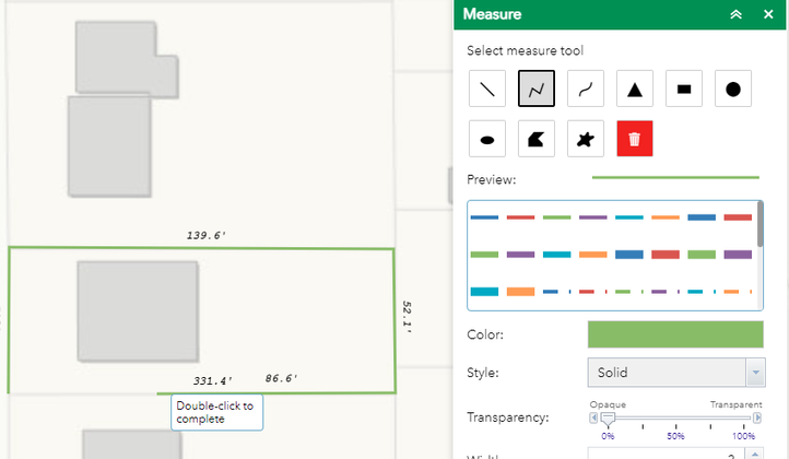

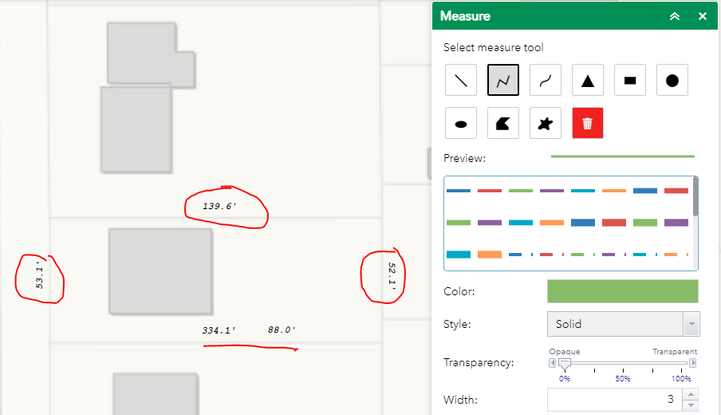

Sketching:
After pressing 'ESC', labels remain
Behavior after:  Cannot see the first segment until the second click and only the last label is displayed upon completion.

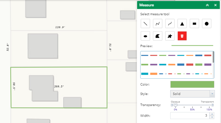

I was able to fix this by adding a 'keydown' bind event in the postCreate function.  I could only get it to work by binding it to the document.body.  Added a conditional to stop the propagation of the 'ESC' if measure.Type is set and to also exit editing if editing is enabled.
this.own(on(document.body, "keydown", lang.hitch(this, function(evt) {
  if(evt.keyCode == keys.ESCAPE) {
    if(this.measureType) {
      event.stop(evt);
    } else if (this.editingEnabled) {
      this.editToolbar.deactivate();
      this.editingEnabled = false;
