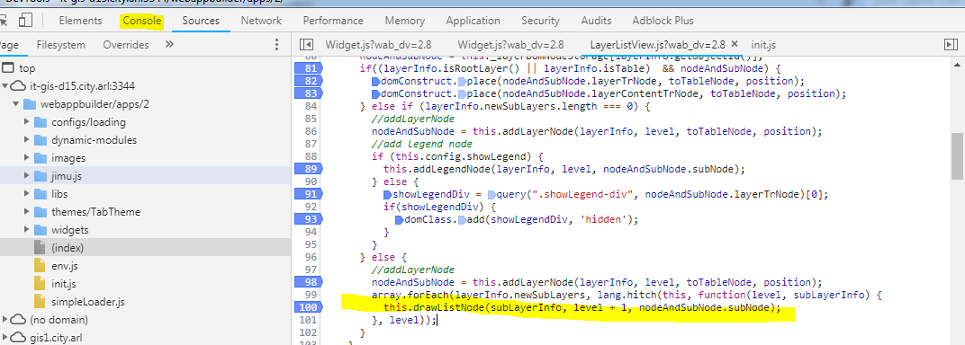

Hi Robert, I don't see any error message in the web debug window's console section. I have noticed that in LayerListView.js file, only one layer's sublayer goes to line 100 to place subnode.

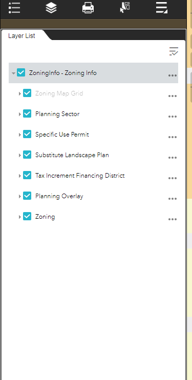

Robert, The map service has sublayers (at least one). if I use the same code and assign only one layer to the layers array (the same layer that has issue being expanded), the layer listed in the layerlist is able to be expanded.
In the screenshot before, Zoning Info is not expandable when added with other layers the same time. When manually add one value to the "Layer" array. It is expandable.Thanks

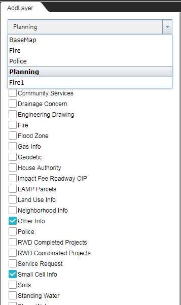

It is through a customized widget that I customized from the Addlayer widget (AddLayer Widget ). The original widget is used to add one layer when a check box is checked. It works with the layerlist which expands the layer node. What I have customized is to add a dijit/form/Select above the layer list in the widget.html. When the value changes in the select, a few map services are added to the map. The map services are added to the map in a loop. I have also noticed that Web AppBuilder build-in Legend widget only display the legend for the layer which is expandable in the layerlist widget.
Here is the code which load a few map services. addLayerToMap is reused from the original code. Themelayers is the array of IDs for map services which will be loaded in the map.
              array.forEach(this.config.layers, function (layer) {
                    if (themeLayers.indexOf(layer.name) != -1) //find the fire
                        //1. Check box checked
                        var cb = registry.byId(layer.name);
                        cb.setValue(true);
                        //2. Load layer to map
                        this.addLayerToMap(layer);
                }, this);
The screenshot below shows when Planning is selected, map services "Other Info", "Small CellInfo", "Trans Plan Info" are loaded to the map.

After further debugging, I found that in LayerListView,js, the layer that is expandable has newSubLayers length >0. And the layer that is non-expandable has the newSubLayers length property as 0. The layer is loaded as map service which obviously has at least one sublayer.
As I said before, when I load only one map service (same map service url), the newSubLayer length is > 0.
Do you know what will be the reason?
Thanks
Helen
Load with other map services
VS - load as the only map service
