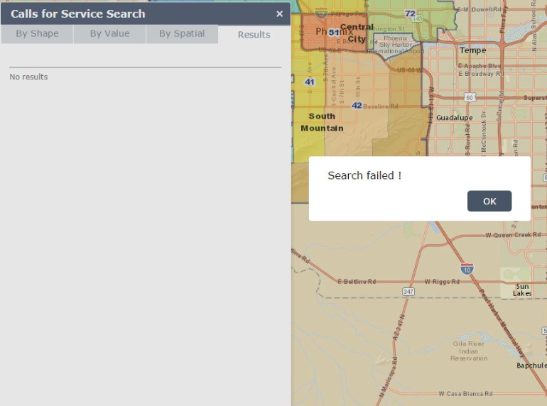

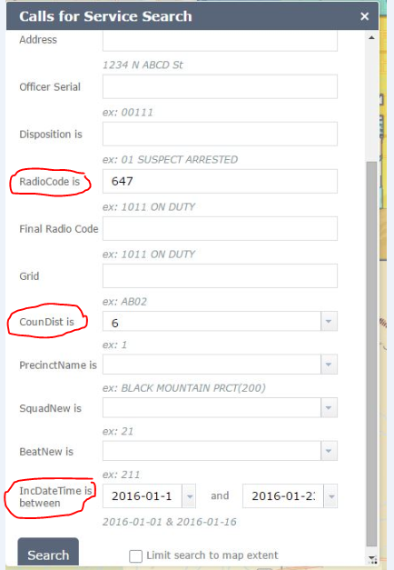

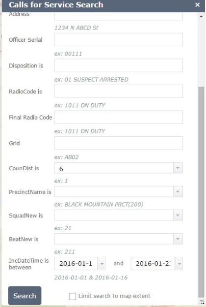

I have a small issue and I was wondering if you had any ideas on how to resolve it. If I select a date range (ex.Jan 13th to Jan 18th) and then choose Council District 6 for example, my result brings back everything in that council district (which is fine).
However, If I choose the same date range, then the Council District 6 and add another selection such as radio code, it give me no results. Overall, it seems as if more than 2 fields to query are selected I get an error. Do you have any ideas how to fix this? Thank you for your help.

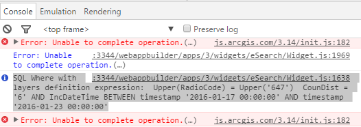

   Look in your browsers web console and see what the SQL Query submitted to the web server looks like and paste that here.

Ok, I think you're referring to this. Not sure why it would not work still.
RudoDuncan
Deactivated User
I see it now, I used AND for Council District, Radio Code and Date. Worked like a charm. I will test using and for the others. I think this should do it. Wow so simple
