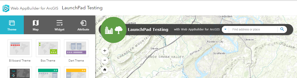

So i wanted to remove the blue logo around the application logo i am building, which i was able to do but now it seemed to have moved the header to the left and cuts off the application name. I tried adjusting the header on the app config.json but it move everything to the right include the logo. How can move just the the black header to the right of the logo?

You must have some other css rules that are affecting this then as you can see by my attached image the css rules I provide work fine for me:
Based on your css code above you are not making the changes in the themes\LaunchpadTheme\styles\default\css\launchpad.css file either (As I had you do in your other threads).
