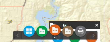

Robert, I how do I change the locations of the tools pop ups when you click on a folder? I assume with the above modifications it affected the display location. Thanks.
RobertScheitlin__GISP
MVP Emeritus
Lefteris,
You will have to change the AnchorBarController
[install dir]\server\apps\[app#]\themes\LaunchpadTheme\widgets\AnchorBarController\Widget.js
(Change line 6)
    _getOffPanelPosition: function(dockableItem, widgetBox){
      var position = {},
          iconBox = domGeometry.position(dockableItem.iconItemNode),
          mapBox = domGeometry.getContentBox(jimuConfig.mapId);
      position.bottom = mapBox.h - (iconBox.y - (MIN_MARGIN + 50));
      if (window.isRTL) {
        if(iconBox.x + iconBox.w - widgetBox.w < 0){
          position.left = 0;
        }else{
          position.left = iconBox.x + iconBox.w - widgetBox.w;
      } else {
        if(iconBox.x + widgetBox.w > mapBox.w){
          position.right = 0;
        }else{
          position.right = mapBox.w - iconBox.x - widgetBox.w;
      return position;
LefterisKoumis

LefterisKoumis
Robert,
Sometimes, I noticed that when I access the app on another workstation that have smaller resolutions the tools from the launchpad theme appear on the right side of the screen! Can it be prevented and be displayed on the top of the menu? Thank you.
MVP Emeritus
Lefteris,
  I don't use the launchpad theme with a header like you are doing here so I have not seen this and don't have any suggestions.
