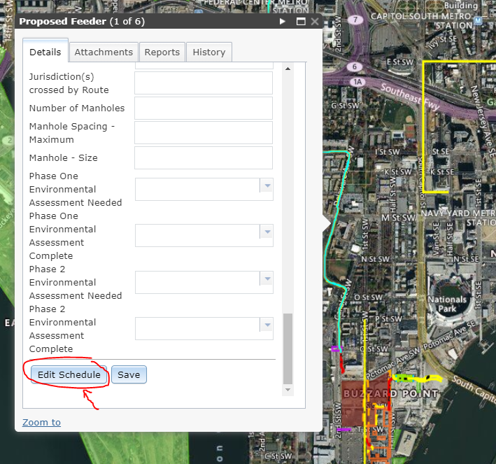

Suppose I have created a button inside a custom InfoTemplate (aka 'popup') widget in my Web AppBuilder app:
 var editButton = new Button({
     label: "Edit Schedule",
     onClick: function () {
         editButton.setDisabled(true); //disable the edit button on first click
 editButton.startup();

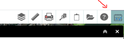

What I want is to launch another widget called 'TaskManager' when the onClick event is triggered. It seems like I need to use a library class called WidgetManager but I can find any practical example for my scenario. It seems like I need to use something like this:
 openWidget(widget)
The openWidget method requires the Widget ID, which I am having trouble locating in my app (I know the name is TaskManager from the manifest.json file but can't find the id attribute). I've also seen example where a function is created, I assume inside the InfoTemplate widget, that will point to the TaskManager widget and can be called inside the click event:

3. Originally, yes, I simply wanted a button in the InfoTemplate that would do nothing more than open the TaskManager widget. However, if you look at the above picture of the InfoTemplate widget open, with the Edit Schedule button (this is the button I made to launch TaskManager), you will see that there is a form. This form is created from the attributes table of the feature being clicked. One of those attributes is "Project Name." Eventually what I want to do is not only open the TaskManager widget, but grab that project name and use it as a parameter to open the Task Manager and preselect a subproject using that "project" name. But for now, just getting the Task Manager to open no matter what feature is selected would be fine.

Yes, InfoTemplate is a custom widget that is essentially a popup that is launched when the user clicks a feature. I have added a button called "Edit Schedule" with an onClick event inside the InfoTemplate widget.js. That button (specifically the onClick event) is what I want to launch TaskManager (Task Manager can also be opened by simply clicking the TaskManager icon on the top navbar). So my workflow would be 1) User clicks on a feature and the InfoTemplate popup is opened. 2) At the bottom of the 'Detail' tab in InfoTemplate, the user will then click on the "Edit Schedule" to open the TaskManager widget. 3) The Task Manager widget opens. It doesn't matter if the both widgets remain open or not, as long as the TaskManager widget is open. 4) Final goal is to have the TaskManager widget also have the project and subproject populated based on the feature attribute called "Project Name" that appears in the form under the Detail tab in the InfoTemplate popup.
