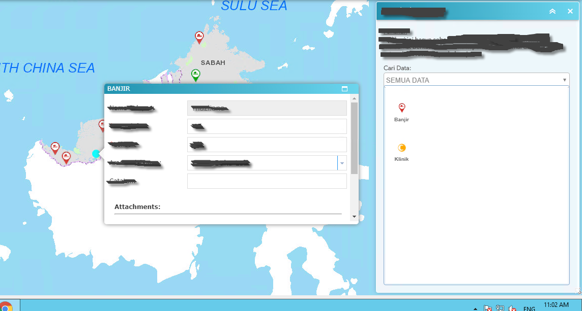

It is possible to turn off map event or disable map click while editor is open in editor widget? Im using Web App Builder for ArcGIS 2.4.
1768
10-10-2019 08:07 PM
mazlianamohd_nordin
shaylavi
Not sure I understand why but you cannot override the map's behavior as far as I know. You can override this by adding an invisible div over the map to prevent the clicks and remove the div when required.
Shay
mazlianamohd_nordin
Hi Shay Lavi,
 Thank you for your reply, my team able to disable map click behavoir while editor widget is open.
I remove the class of visible widget and off the click behavoir in map container class
$('#map_container').off('click');
$('#map_container').dblclick(false);
