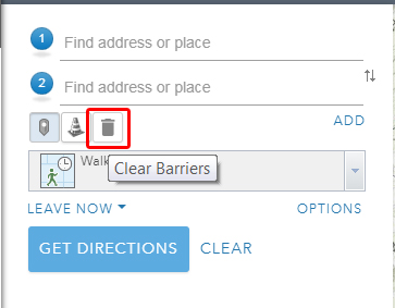

Siva,
   Here is what you need to customize the directions widget to do that:
In the Widget.js (lines 3-17 need to be added to the _onDirectionsActivate)
      _onDirectionsActivate: function () {
        //Add the clear barrier button
        require(['dojo/query', 'dojo/dom-construct'], lang.hitch(this, function(query,domConstruct){
          var clearLink = query('.esriStopsAddDestination')[0];
          var clearBarLink = domConstruct.create('div', {
            'class':'esriClearBarrierButton esriDirectionsButton esriDirectionsTabButton',
            title: 'Clear Barriers',
            style: 'display: inline-block;'
          }, clearLink);
          on(clearBarLink, 'click', lang.hitch(this, function(){
            if(this._dijitDirections.routeParams.polylineBarriers){
              this._dijitDirections.routeParams.polylineBarriers.features = [];
            this._dijitDirections._polylineBarriersLayer.clear();
            this._dijitDirections.getDirections();
        if (this.config.defaultLocations &&
          this.config.defaultLocations.length && this.config.defaultLocations.length > 0 &&
          false === this._isInitPresetStopsFlag) {
          this._isInitPresetStopsFlag = true;
          this._dijitDirections.addStops(this.config.defaultLocations);
In the css/style.css add this rule at the very bottom of that file:
.jimu-widget-directions .simpleDirections .esriClearBarrierButton {
  background-image: url(../../../jimu.js/css/images/rubbish_bin.png);
  opacity: 0.8;
  filter: alpha(opacity=80); /* For IE8 and earlier */

SivaramKrishnan2
Robert,
Thank you so much for the response,
It is working without any issue at my end when i implement this code snippet into my application.
