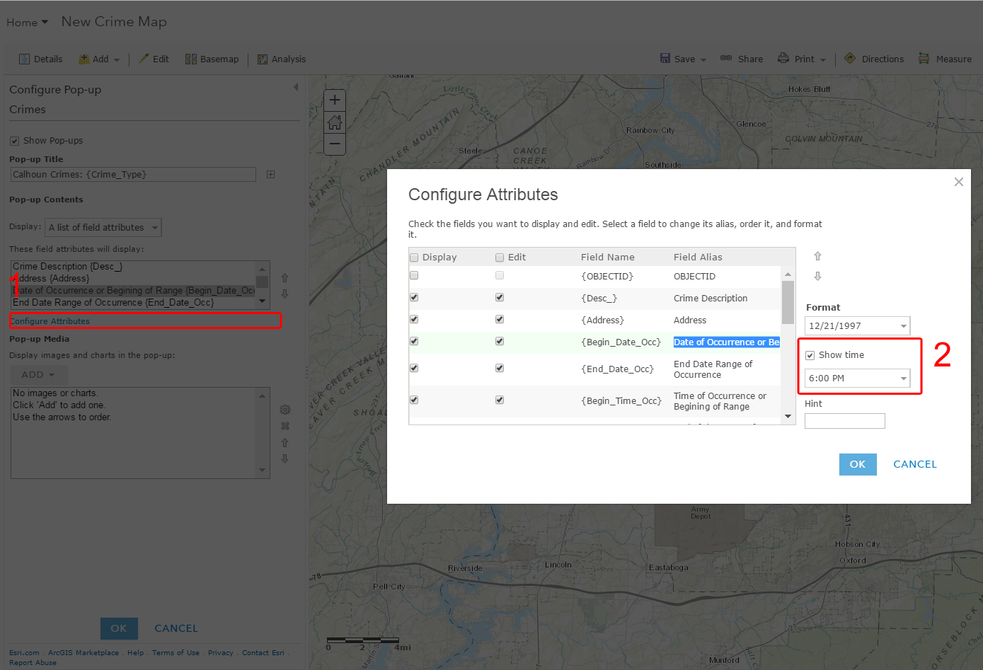

Juan,
  In your web map did you configure the popup and for that field did you check the show time?
If so then you should see a time field also.

Juan_ManuelAngel
Thank You Robert that was the solution ! Its help me a lot.
