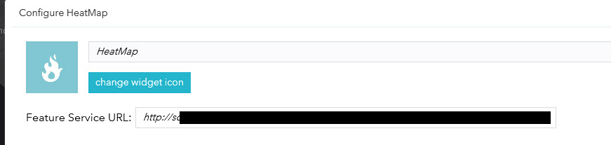

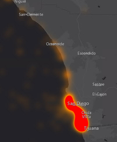

UPDATE (5/4/2017) - looks like that older 1.3 version of the heatmap widget works in WAB 2.3. In its original form, its limited as the user cannot choose which layer gets rendered - the author of the map decides the URL of the layer to be rendered (see below), the user can only click the 'heatmap' button.  Once this is done, the render layer is added to the map (and in the 'layer list') and the glow appears
I would gladly donate to someone who could provide code which would allow the user to enter their own URL when the widget is invoked.   Being able to render a heatmap like this on the fly without having to go through AGOL/portal would be very helpful...
