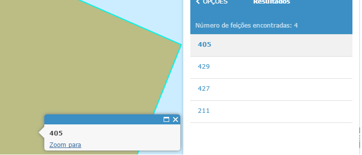

deleted-user-0W0-oLHxDjCX
Deactivated User
Here is my pop-up and attribute table (result of the spatial selection on Query Widget). As you can see it has only one field on pop-up and two on attribute table (even setting fields ["*"] on config file.
