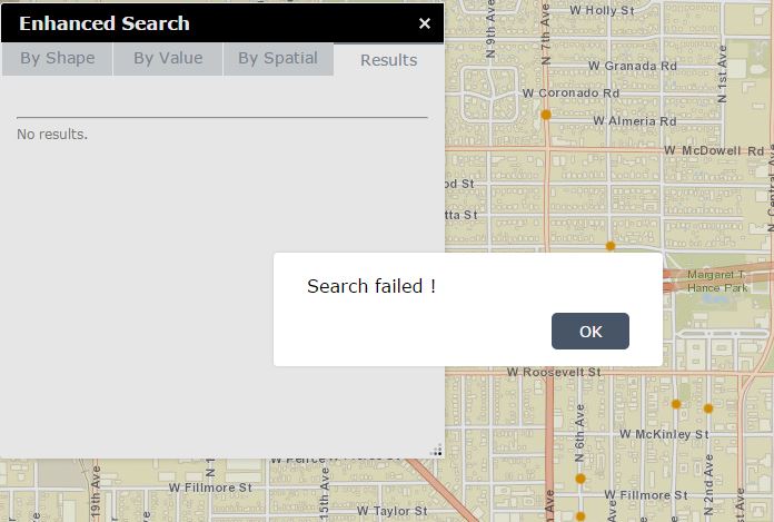

Hello All,
I have deployed eSearch Widget and configured in Web App Builder. But when I'm trying to search (By Shape, By Value, By Spatial), it says "Search Failed".
Please find the error and configuration details in below screenshot for your reference:
Please let me know where I went wrong. Appreciate your support on this.

Krishna,
   I notice that you have the layer symbology set to "from Layer" did you click the link right below that "Add/Edit Layer Specific Symbology"? I was able to get the search to fail if you set the "Layer Symbology" to "from Layer" and do not actually add/specify the symbology.

KrishV
Hi Robert,
Thanks for your quick response..!
Yes, I have selected "From Layer" Radio button.
I'll try to reconfigure without selecting "From Layer" and let you know..
Thank you so much..

KrishV
Hi Robert,
Yes, you are right. Now, it is working.!
