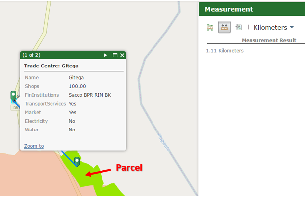

- I know that there is a parcel in about 1 km distance from this trade center:
But when I perform a spatial search with these settings:

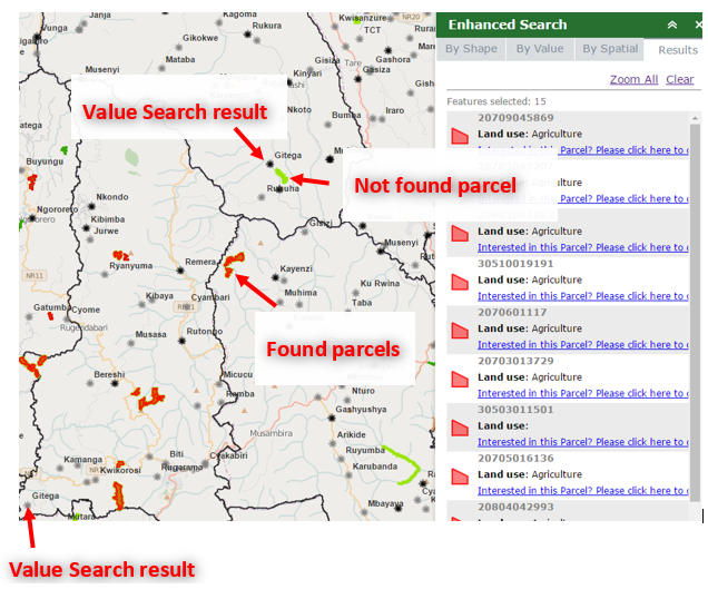

-> I get a result of 14 parcels with the last buffer option but not the one I expected:
So I wonder at which point I have a misunderstanding of the spatial search function. The app is in "work" mode available on http://www.nicoleueberschaer.de/minagri/   if you want to try it yourself.

I used the value search, typed in the name, pressed the search button, went to spatial search, chose the parcels as search entities layer and clicked then "intersected by" search button. -> no Result
When I do a shape search on the same market (with a circle) and check the option Buffer Graphic 1 km and then go to spatial search, define a 2.5 km search distance and click again the "intersected by" search button I get the message. When I then click the buffer I get the expected parcel, when I click selection then I get no Result again. At this point I would have expected that the search distance is added to the before defined buffer when I click the buffer button.
