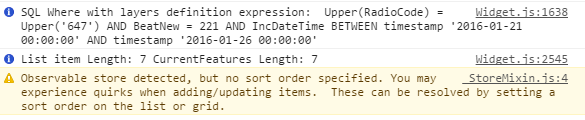

If I query only by Start/End date I get this error when I look at the console.

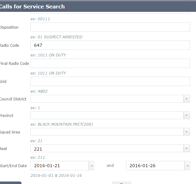

When I add Radio and Beat with Start/End date I get this warning.

   The warning is normal (nothing to worry about). The errors look like they are coming from the graphic results of the search. Do you have null geometry in your data?
