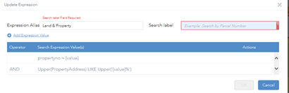

Hi Robert,
Is it possible to configure an expression without placing text in the "Search Label" display. At the moment you can't as its a requirement. I'm trying to give more space in the search display by removing this Label. See screen shot. I have removed it from the "config_Property Searching.json" file and the app works fine but then when I go back into the config it requires an entry.
Any advice would be useful
cheers
Rod

Rod,
  I agree that this text element should not be required so I will add this change to the next release. Here are the changed files if you want this before I get the next release published.
The attached zip only contained the three updates files and the folder structure of where they go.
