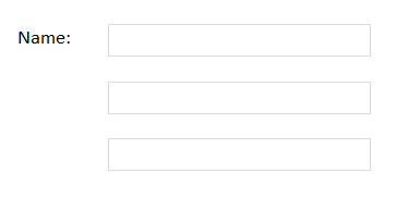

I need to add a expression value which should search for 2 (or more) columns. But on display, only single input is provided
You just click the "Add Expression Value" again in the configuration UI and you specify the OPERATOR to be AND or OR.

b) I understand OR operator needs to be used. But in final widget screen I need to see single input text box, but when I un-check "Ask for values", screen looks like this. I want one input text box which should search multiple columns using OR condition.
