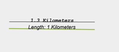

 The Enhanced Draw widget is incorrect in measuring both distance an area. For example: below the upper line is showing 1.3 km, the lower line, created by using the inbuilt ESRI draw widget shows 1 km. Not sure where to correct the code to fix it.  The enhanced widget is so much better that Esri's in-built one, so I would love to continue to use it! Please update this thread if you found a solution. Thank you!

Hi Nadia, Did you find a solution for this, i have the same issue, the same issue occuers in the demo app as well as the app we implemented and when compared to the esri (and real life) measurements, it is definitely out but i wouldn't have the foggiest to know how to look at the code to rectify it.

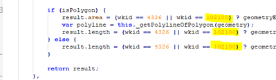

I was still experiencing the inaccurate measurement results using release 2.8.1. I am on Enterprise 10.8.1, was using this through WAB as an added custom widget (not dev edition), and in use in a Launchpad theme app in the anchor bar controller. I am in Alaska where every measurement oddity gets exaggerated; linear measurements in farther north places would be 3x too large, less far north measurement would only be 2x.
The FIX for me (inspired by other comments in the previous 25 pages) was to edit the Widget.js file and on lines 1496, 1498, and 1500 of the Widget.js file, change "3857" to "102100". The "4326" values could stay as they are. Linear and areal measurement are now both correct.
@Nadia @Barned01
