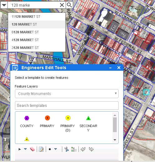

My search widget always zoomed to the results.
I added the Edit Widget to my project and it works.
Now the Search widget will NOT zoom to the results and only displays a blue box of the result. No Zoom too.
I removed the Edit widget and the Search widget works again.....
The error that I receive is "TypeError: Cannot read property 'layerInfos' of undefined"
This only occurs after I add the Edit widget to my project.

Also attached is some error codes when a Search is performed.
