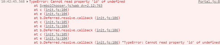

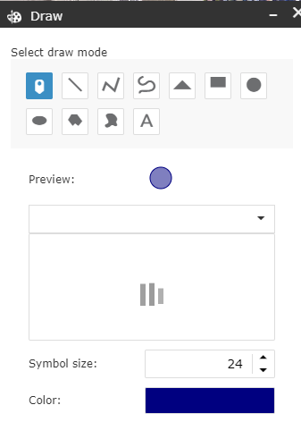

Hi all, I'm working outside the portal for arcgis with local layers in a intranet.
When I run the Draw Widget I get an error:
and it seems like with this widget it is required to contact the Portal to _fetchSymbolTypes.
Is it possible to load the point symbols list without the portal?
I report the error, as you can see no symbol is loaded:

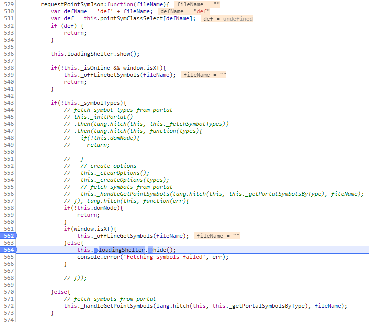

   In the apps jimu.js\dijit\SymbolChooser.js have this change to the _requestPointSymJson function:
    _requestPointSymJson:function(fileName){
      var defName = 'def' + fileName;
      var def = this.pointSymClassSelect[defName];
      if (def) {
        return;
      this.loadingShelter.show();
      if(!this._isOnline && window.isXT){
        this._offLineGetSymbols(fileName);
        return;
      if(!this._symbolTypes){
        // fetch symbol types from portal
        // this._initPortal()
        // .then(lang.hitch(this, this._fetchSymbolTypes))
        // .then(lang.hitch(this, function(types){
        //   if(!this.domNode){
        //     return;
        //   // create options
        //   this._clearOptions();
        //   this._createOptions(types);
        //   // fetch symbols from portal
        //   this._handleGetPointSymbols(lang.hitch(this, this._getPortalSymbolsByType), fileName);
        // }), lang.hitch(this, function(err){
          if(!this.domNode){
            return;
          if(window.isXT){
          }else{
            this.loadingShelter.hide();
            console.error('Fetching symbols failed', err);
      }else{
NatashaManzuiga
Hi Robert, I modified the function as you suggested.
But when I run the widget I'm getting the following error... the fileName...is an empty string....
