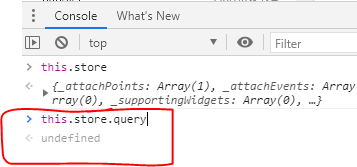

PrashantKirpan
Yes but not found query object after store dot -  "store.query"
I can see data in store but quey is undefined.
PrashantKirpan
Solved by changing Required module order.
