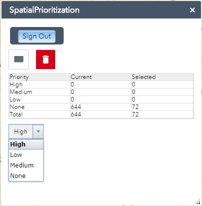

KenBuja
MVP Esteemed Contributor
This is how I set up a Select box (attach point selectPriority) in my widget
<div>
  <div data-dojo-attach-point="btnSignIn"></div>
  <div data-dojo-attach-point="loginNode" style="display: none;">
    <div class="select-dijit-container" data-dojo-attach-point="selectDijitNode">
    </div>
    <div data-dojo-attach-point="totalGrid"></div>
    <div data-dojo-attach-point="selectPriority"></div>
    <div class="config-section">
      <div data-dojo-attach-point="btnApply" class="jimu-btn" style="margin-top: 20px;">Apply</div>
    </div>
  </div>
  <div data-dojo-attach-point="shelter" data-dojo-type="jimu/dijit/LoadingShelter" data-dojo-props="hidden:true"></div>
</div>‍‍‍‍‍‍‍‍‍‍‍‍‍‍
        var store = new oldMemory({
          data: this._arrayPriority
        var os = new ObjectStore({ objectStore: store });
        var s = new Select({
          store: os,
          style: "margin-top: 10px;"
        }, this.selectPriority);
        s.startup();

This is how I set it up in the widget. This code fragment is in a function that is called in the postCreate section of Widget.js.
