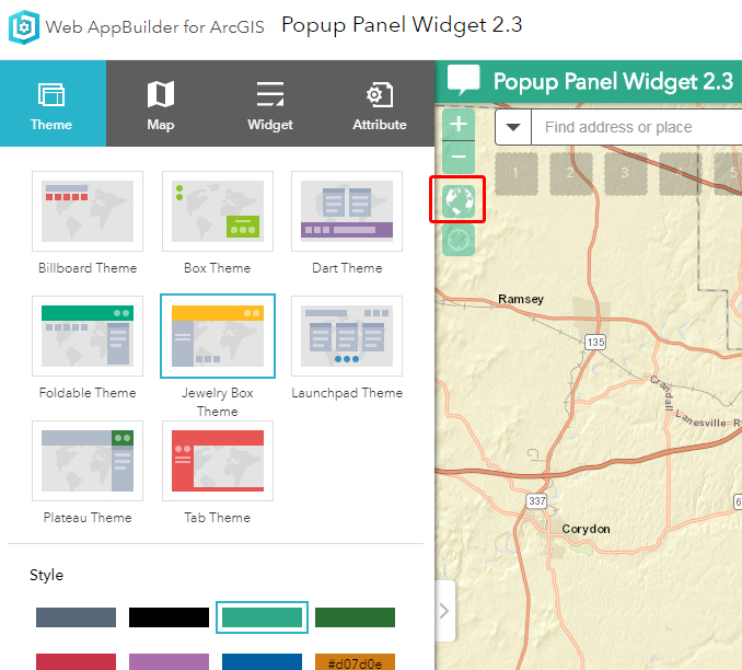

Hi , I'm trying to change the icon of Home Button WAB 2.3 . The 'Change Widget Icon' option is disabled for the Home Button and all the default widgets. How do I change the 'Home Button ' Icon in WAB.

Thanks Robert. Actually , the problem is only with the Launchpad theme. I'm able to see the changes reflected in other themes. The problem is I have developed the custom widgets within the same application and users approved everything else and this is the small change they seek for. I'm trying to see to add custom home button with my desired icon.
