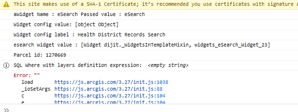

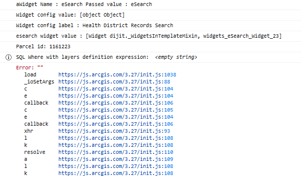

I am trying to create a custom feature action in webmap popup which basically passes the value of the feature clicked to the eSearch WIdget and perform a search. I have been able to successfully add the feature action to the popup and it opens the eSearch widget, but when trying to use the Search function like you mentioned above, I get an error message saying "Search failed". Looking at the console, it looks like it is sending an empty String to the function.

Here is the console message I am getting:

Anish_Adhikari
I am still seeing the error message after the change. I deleted all the browsing history data just incase but I am still having the same issue. Here is the screenshot.
