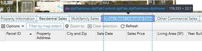

How can I define a individual color for each tab in the AttributeTable widget?

   How in depth are you wanting to go?.. A specific color for a specific layer or just a different color for each tab?
CurtNielsen
Hi Robert.
Just a different color for each tab.
RobertScheitlin__GISP
MVP Emeritus
Curt,
  In your apps themes\Theme name\common.css add these rule (you need one for each tab):
div[widgetid="dijit_layout_TabContainer_0_tablist_dijit_layout_ContentPane_0"] {
  background-color: beige !important;
div[widgetid="dijit_layout_TabContainer_0_tablist_dijit_layout_ContentPane_1"] {
  background-color: rgb(160, 160, 83) !important;
div[widgetid="dijit_layout_TabContainer_0_tablist_dijit_layout_ContentPane_2"] {
  background-color: rgb(96, 160, 83) !important;
Just sequence the number at the end of ContentPane_
CurtNielsen
Super! Work great!
