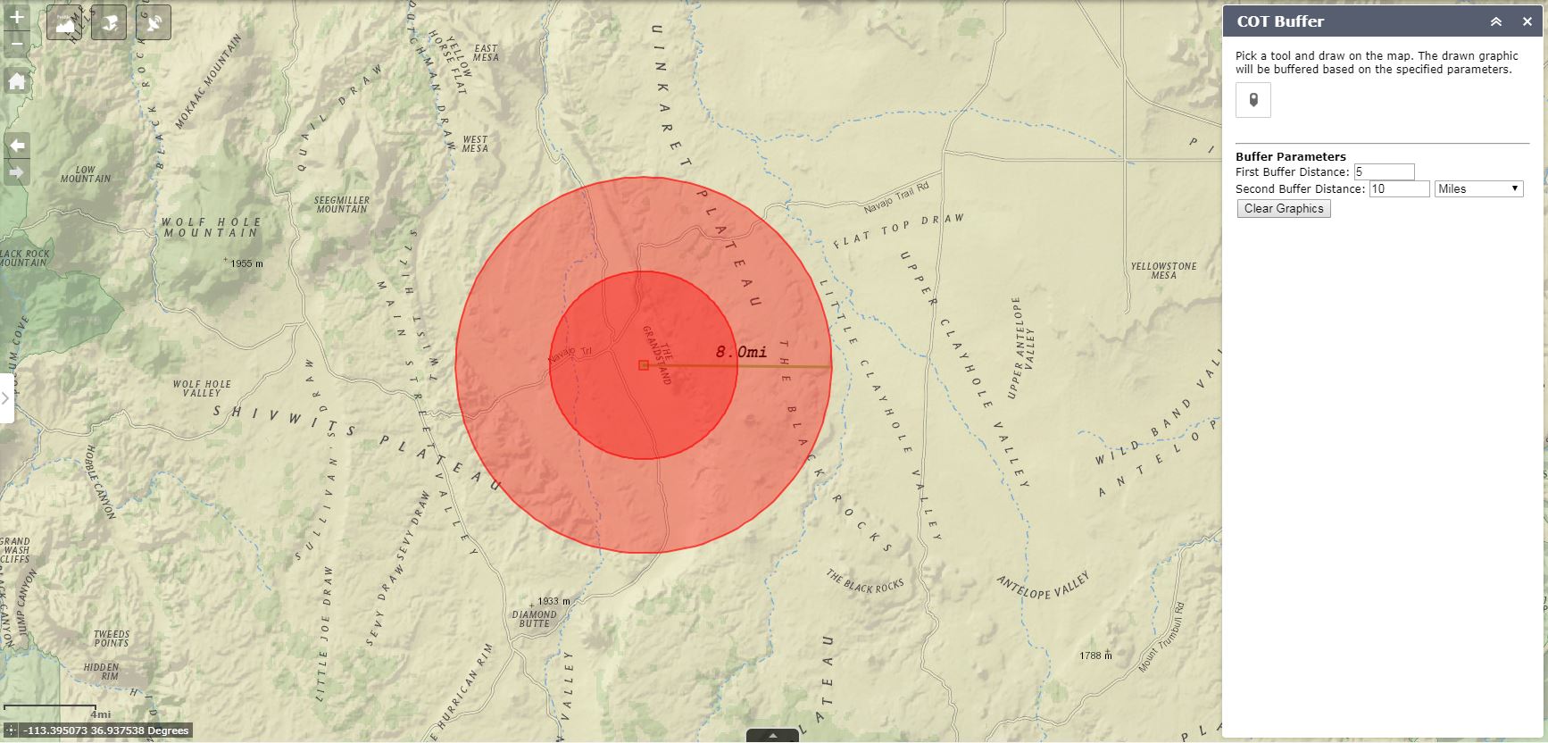

I downloaded the cotBuffer.zip and added it to my web appbuilder and it works. My problem is the buffer distances don't match the map distances. I put the buffer distance as 10 miles and it draws a circle with 8 mile radius. What do i need to change to get the distances all the same?

   It looks like you are using a standard esri basemap and thus need to use a geodesic buffer.
params.geodesic = true;

Yep. After trying different things for hours playing with WKIDs and spatial references, I came to that answer right after I posted the question. Thanks Robert!
