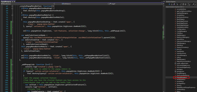

I am trying to add a button or a link to the popup that will do a custom action. As I have been directed to other questions, I did something like this
_createPopupMenuButton: function(){
        if(this.popupMenuButtonDesktop) {
          html.destroy(this.popupMenuButtonDesktop);
        if(this.popupMenuButtonMobile) {
          html.destroy(this.popupMenuButtonMobile);
          this.popupMenuButtonDesktop = html.create('span', {
              'class': 'popup-menu-button'
          }, query(".actionList", this.popupUnion.bigScreen.domNode)[0]);
          on(this.popupUnion.bigScreen, 'set-features, selection-change', lang.hitch(this, this._addPopupLink));
        var mobileActionListNode =
          query("div.esriMobileInfoView.esriMobilePopupInfoView .esriMobileInfoViewItem").parent()[0];
        var mobileViewItem = html.create('div', {
            'class': 'esriMobileInfoViewItem'
          }, mobileActionListNode);
        this.popupMenuButtonMobile = html.create('span', {
        }, mobileViewItem);
        on(this.popupMenuButtonMobile, 'click', lang.hitch(this, this._onPopupMenuButtonClick));
        on(this.popupMenuButtonDesktop, 'click', lang.hitch(this, this._onPopupMenuButtonClick));
        _addPopupLink: function (evt) {
            console.log("created a popup link");
          ////if the link is added to the popup remove it.
          if (query(".action.action-relatorio", this.popupUnion.bigScreen.domNode)[0]) {
              html.destroy(query(".action.action-relatorio", this.popupUnion.bigScreen.domNode)[0]);
          //get the popups selected feature
          //now that you have the slected feature you have access to its
          //attributes that you can add to the hrefs link
            var selFeat = this.popupUnion.bigScreen.getSelectedFeature();
            console.log("selFeat", selFeat);
              //Create link
              var linkRelatorio = html.create("a", {
                  "class": "action action-relatorio",
                  "id": "actionRelatorio",
                  "innerHTML": "Abrir Relatório",
                  "href": "localhost/SigFepamRelatorios/Relatorio.aspx?idRelatorio=1&atanId=",
                  "target": "_blank"
              on(linkRelatorio, "click", this._onActionRelatorio);
          _onActionRelatorio: function (evt) {
              var selFeat = this.popupUnion.bigScreen.selectedFeature();
            //TO DO
but so far, I cannot see a button. I cannot even log the console.log on line 28 & line 37. Any pointers on what the issue could be?
