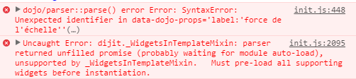

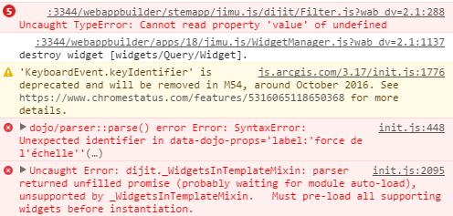

Can you check your browsers web console to see if there is a different error now?

   That part that is hard for me to understand is that in version 2.1.2 of the eSearch widget the nls\fr\strings.js file has
forceScale: "force de l\'échelle", (notice the \ escape of the ' character).
Your error is indicating that the escape \ is not present which points me to the issue that you are not using the latest version of the eSearch.

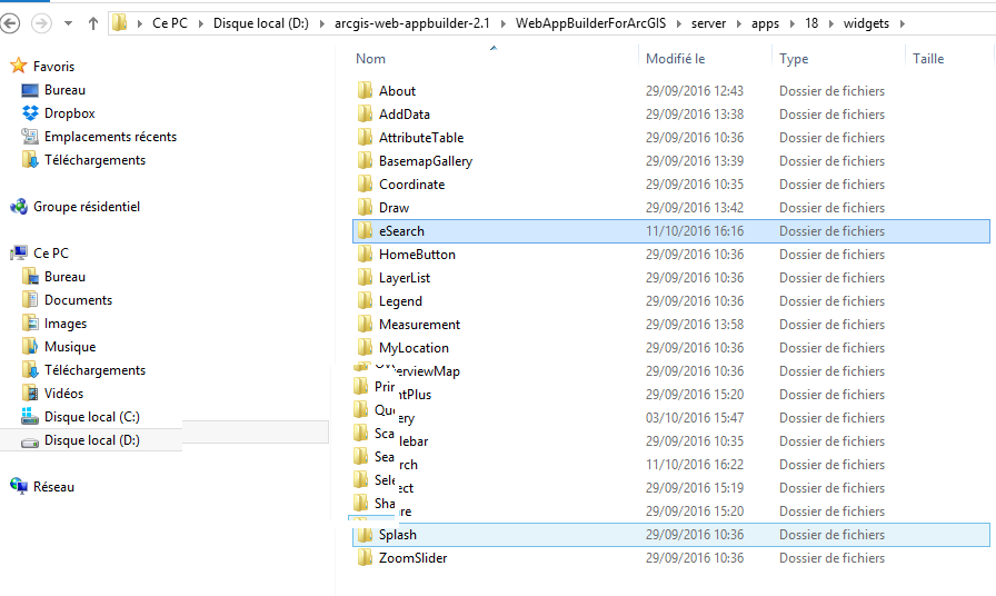

Can you look at your D:\arcggis-web-appbuilder-2.1\WebAppBuilderForArcGIS\server\apps\18\widgets\eSearch\manifest.json and see what version is presented in that file (i.e. "version": "2.1.2",)?

   Can you post the contents of your D:\arcggis-web-appbuilder-2.1\WebAppBuilderForArcGIS\server\apps\18\widgets\eSearch\nls\fr\strings.js then.

RobertScheitlin__GISP
MVP Emeritus
Amal,
   That is for the English strings I need to check your french strings.
