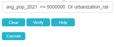

Requests:
A. Make the query window space (where the query statements are being written), larger and not a just single line window. Very helpful if you have 4 or 5 fields you need to query.
B. Change the message "There expression was successfully verified" to "The query expression was successfully verified". I tried changing this in the "Widgets.js" file and re run the startup.bat file but it did not take into effect. I am not a programmer, so not sure really how to go about this. Willing to learn if anyone can point it out.

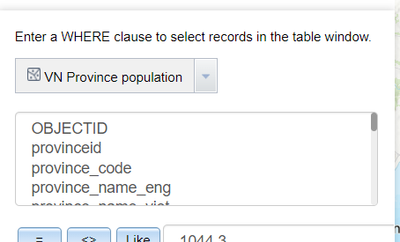

C. Be able to display Field Alias instead of Field names. It would be very helpful for other users to understand what the field their querying is all about.
D. Display the Layer name correctly. Here, my layer is named as VN Province population but it shows some layer ID or something else

cmlosaria_gis
Hi,
Hopefully someone can help me.
How/what to edit to show actual layer name instead on layerID?
