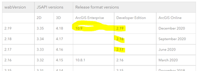

var apiVersion = '3.xx';
to
var apiVersion = '3.35';
AND
apiUrl = 'https://js.arcgis.com/3.xx';
to
apiUrl = 'https://js.arcgis.com/3.35';
and then clear your browsers cache.

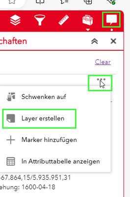

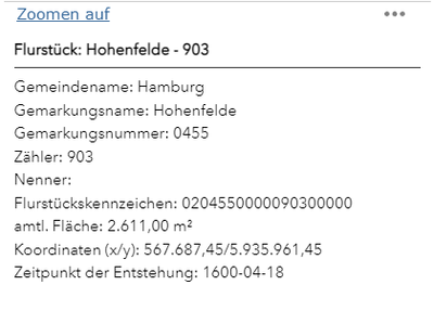

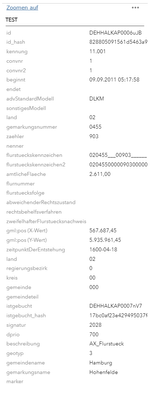

The Widget provides the user the possibility to create a new layer in the Webapp through the action “add layer/create layer” in the pop-up. We noticed that the newly added layer does not show the original pop-up of the portal item or the pop-up configured in the web map, but just lists all the attributes.
Create Layer/Add Layer
Original Pop-Up
Pop-Up of created Layer
  • Is it possible adapt the code, in order to delete the action “Add Layer/Create Layer” from the Pop-Up?
  • Or is there anything we can do, so that the original pop-up is shown instead of a list off all attributes?
Thanks!
