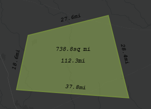

Thank you for the BEST measure widget available!  I have this widget included in all of my web apps.  Yesterday a user contacted me that they were having issues with Acres and Total length printing on top of each other.  I jumped out here to see if others have had this issue and I see that last fall there were a couple posts with the same issue.  This is the link to one of my public facing GISVIEWER sites with this widget installed.  It is built on WABDV 2.17 and the measure widget version from the manifest is "version": "2.4", I believe this to be the latest, I downloaded a new version just now and the manifest files match.  I'm using the standard print widget from esri with a few mods.
I should also  point out this is only happening when the shape drawn is a closed feature like a polygon.  I tested in Chrome and Firefox and both yielded the same result.  Do you have any advice on how to fix this issue or maybe remove the total distance value so that only acres is shown and prints?  Acres/area are the important thing for my users to see.

Hi Tom,
I am experiencing the problem of Area and Total distance overwriting each other on printouts when creating polygons and printing with the ESRI print widget.  I am seeing this on all my apps and am experiencing it with Chrome and Firefox.
Is there a quick way to disable drawing the total distance label as a workaround for my users?  They are concerned with Area only and I don't want to add a second measure/draw widget to do this for them.
Right now my workaround is to have them take screen snips with the windows snipping tool.

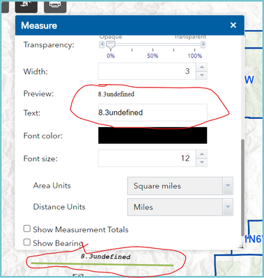

JwHayes
Hello!
This is a great widget! Just what my group wanted. I've installed it on WABDV 2.25. It's calculating the correct measurement but the unit label always says "undefined." I've done some digging around but nothing jumped out to me. Does anyone have an idea of what's happening? Thanks!!
