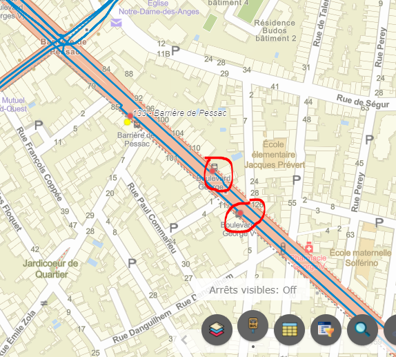

KARIMLABIDI
Hello Robert,
It is possible to reverse the On/Off? On my map, the bus stops are visible by default. When I click on the
widget, it puts Off ,it's normal because the layer is visible by default. I would to know if it's possible te reverse that , for my users ,it will be easier to understand what happens on the click!
Thank you Robert and thank you for all your widgets!!
RobertScheitlin__GISP
MVP Emeritus
@KARIMLABIDI
You control the initial layer visibility state in your web map that WAB is using. The widget does not control that.
KARIMLABIDI
Yes I know that but the "on/off" is a litlle bit confusing for my users. Do you know if it is possible to change these names as I want?
MVP Emeritus
@KARIMLABIDI
OK now I understand your issue.
You can follow the directions in the downloads readMe.txt to set the initial state of the button to be toggled on
